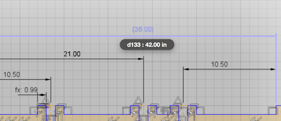

Ok, I think I might have found another similar bug...
In this sketch I am trying to get the three slots to be evenely spaced. I drew a driven dimension at the top. The two side ones are that dimension divided by 4. The middle one, being in the middle needs to be that dimension divided by 2. The way I've been creating these is to draw the dimension, click the one I'm referencing to (like d111) and it populates it, then I'll add the math (like "/2")
This is working for me all over the place except here. Try adjusting the "Width" parememeter and watch what happens. Then try to correct it by re-drawing the dimension. It won't work. In fact, when you hover over it, it shows the wrong dimension:
Did I screw up here or is this a bug? Thanks for all your help by the way.

So, this is mostly working as it is supposed to.
The miscommunication here is that you cannot associatively reference a driven dimension in an equation.  Notice that the equations for your "spacing" dimensions are expressions such as "42.0 / 2":
This will always evaluate to 21.  It is not referencing another dimension.
How did this happen?  Well...  When we added the ability to click on a dimension when editing another dimension, we had a problem:  Because Fusion does not (yet) support associative references to driven dimension we had a spec question:  "what should we do if the user clicks on a driven dimension?".  And the answer was:  "just use the current value of the driven dimension".  Whether this is a good answer or not is arguable.  Fusion should probably at least issue a warning in this case.
The fix here is a more complex equation.  I created a user parameter which was "slots_width" and which had the value "Width - 2.0 * (d125 + d124)", and then changed those 3 dimensions to have the correct equation:  "slots_width/2.0", and "slots_width/4.0".  It works OK then.
The one thing that is definitely a bug is the hover text is wrong:
The value shown in the actual dimension (the green dimension) is correct, just the value you get in the "d133L 42.00 in" preview is wrong.  I'll report this so we can fix it.
