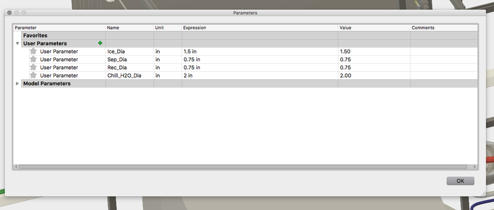

neljoshua
@oaklander,
One way to do this would be to use a parameter and have a different dimension for each part.  You could set a different length for each extrusion or a different diameter for each hose.  I have used the parameters to set hose sizes in one of my designs.  Click Modify/Change Parameters to access this menu.  Then set the values you want.  Once you create an extrusion, hose, etc, you can use the variable you created for the value in question.
