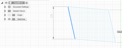

fsonnichsen
Showing missing constraints

it is entirely possible that that sketch does not have any constraints, that's why you don't see them.  Try adding a Vertical, or Parallel constraint to that sketch - does it still not show up?

  I think the (2.0) indicates that this is a constrained value--I have the equals constraint set.
I tried the parallel one as you suggest and it will not accept it. I get the message: "select other geometries" and the constraint does not take.
Message 11 of 34
TheCADWhisperer
The (2.0) indicates that this as a Driven Dimension.
Can you Attach your *.f3d file here?

a couple of things here:
  1. dimensions are not constraints.  They are separate things.  Constraints are things like parallel, perpendicular, etc.
  2. That "(2.0)" dimension, to me, looks dimmed out.  That would imply it is from the other sketch in your design.  As @TheCADWhisperer requested, if you share your design here, it will be much easier to see what is going on.

What do you see if you click on the arrow to expand your Sketches folder?
Your Timeline indicates that you have two sketches.
Which sketch is active?
In the image below - the geometry is in Sketch1, but my active Sketch is Sketch2.
I cannot add a Parallel constraint in Sketch1 without Finish Sketch2 and Edit Sketch1.
(My guess is that you already have Parallel constraints in Sketch1, but don't see them as Sketch1 isn't active.
