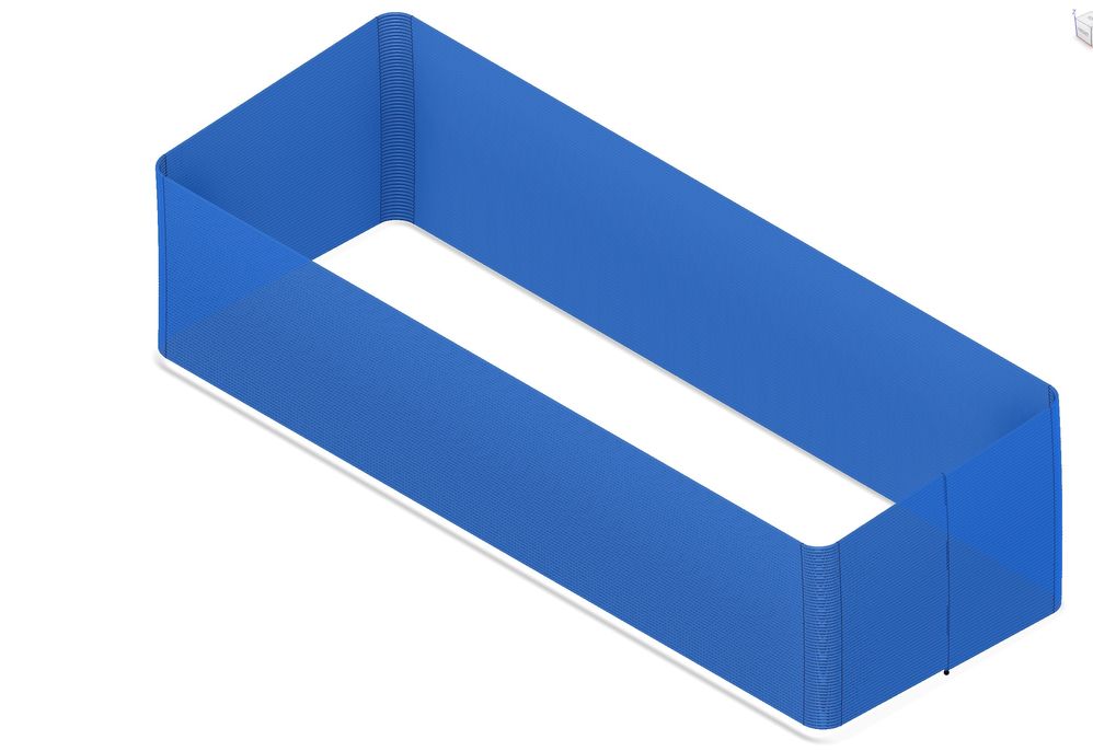

I want to do a magnetic field simulation for a rectangular coil. So I want to design a rectangular coil in fusion 360. I know how to design a rectangular coil in fusion but the coil I want to design is little different. I also want layer on top of the coil. I am not able to add layers please someone help me. It would be really helpful for me.

Well, start by drawing a line with the outside (or inside) length of the rectangle.  Add another line at 90 degrees, then one parallel to the first, then one 90 degrees the last which is the width of the wire shorter than the second wire.  Continue this until you have 100 turns.  Use this as the path in Plane along Path.  Create a sketch on the path with the profile of the wire.  Sweep this along the path.  Rectangular pattern for the number of layers.

Reference to the figure, suppose I have a long wire starting point A , after making 9 rectangular loops(sidewise)
i want to wrap the wire on top of the 9th loop, then 8th loop , similar way upto 1st loop (I.e wrapping IMG_2870.jpegin the backward direction). Then again wrap the wire on top of the 1st, then 2nd upto the 9th loop( forward direction)

It looks better from afar than close-up...My attempt using Emboss to create a path for the "Slope" failed due to incorrect geometry...Coil.jpg
and of course, the step out to subsequent layers and wind patterns will ad complexity...There has to be a better way I hear myself saying!
It is one Solid body but I guess it will need to have some tolerances so a wire of considerable length is created.

Try mirroring that, then use a joint to position it.  Or do a rectangular pattern then add a 'U' shape to connect each.

Is there a reason you need complex detailed geometry - or will a cosmetic texture that "looks right" suffice for your design.

Understood. Partly easy ...mainly difficult in Fusion 360 for me at least! The Crossovers and/or the step out to the next layer.

Does this .STEP file work in your "other software"?
One Solid Body:

In this post I demonstrated how to use a Swept surface with a twist to create a helix then trim to a helical rectangular form.
