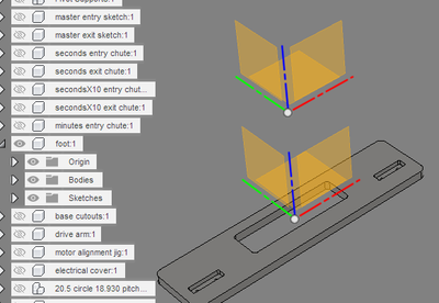

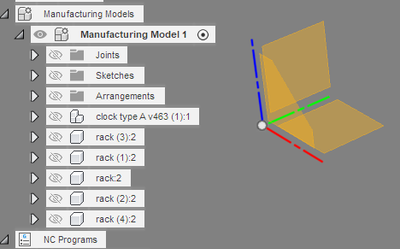

When in the CAM workspace manufacturing model the Origin from the Design workspace is always visible.
Using Find in Browser takes me to the Manufacturing Model  but with everything turned off in the Manufacturing Model the Origin is still visible.
Turning off the Manufacturing Model causes it to go away but so does the entire model so not a solution.  Just want to turn off he Origin
Usually not  a problem - just would be nice to not clutter up the screen.  Is there a way to hide this origin?

you're not showing the whole tree in your screen shot, is it not higher up above the models?-

@laughingcreek
Screen shot of the top of the tree - The Origin just below named views  is turned off and Design Origin still visible.
I think I have every origin turned off.

more info - tried to edit orginal post but did not go well with the new forum layout
the origin for the component turned on
The origin for the component turned pff

IDK, that is weird.  I've never seen a situation where the origin couldn't be turned off.  you can select one of the axis or planes, and it will show you where it is located in the tree. (you're sorta doing it in your pic from post 3, but can't see the whole thing so I cant tell)
also, fusion does this fun thing where certain commands will make the origin axis/planes visible while active, but doesn't turn the eye-ball on.  supper annoying when doing boundary fill in the modeling workspace.
just spit balling, you may have to attach your model for a closer look.  if you absolutely can't turn the origin visibility off, then there's a bug and it should be reported.

Attached is a file created be deleting everything except the one component that I have have shown in the screenshots.  Design timeline has one warning and as I did a combine "cut" with a deleted component.  The component shown is a revision to a previous component so time line is rather convoluted.
Still the same problem with the origin not being able to be turned off in the manufacturing workspace.  The design origin is in a different location than in previous screen shots as I removed a MOVE command thinking that might have something to do with the persistent display of the origin.

Learned a new trick today - thank you.  Interesting that after Toggling the Origin as you show in your video it can then be toggled without going into Manufacturing Edit.
