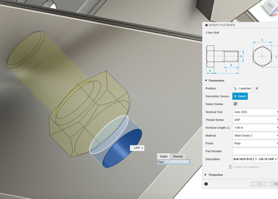

I am trying to use the insert fastener tool, but I can't get the fastener to face the right direction. I have tried multiple holes and faces, and it seems only to let me place the fasteners facing outward (See Screenshot).

I was attempting to do this, but I could only select the inner face. It might be an issue with the "Structural Member" add-in I used to create the member.

the secondary face needs to be planer.  I can't tell from the pics if it is or isn't, but I'm guessing not

 I guess that you have design with SURFACES and Fasteners are inserted on one side only, right ? In this case, you can insert Fasteners on "SKETCH POINT(s)" and there is an extra option "Flip" which you can use it directly from the Insert Fastener command. For more information see video :
