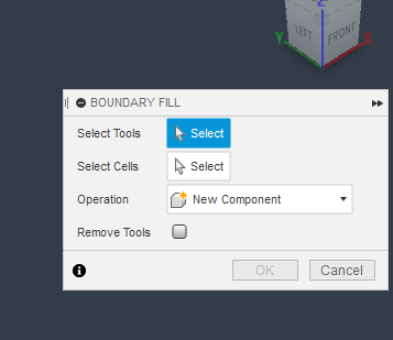

TrippyLighting
Don't copy/paste bodies. If "something " goes wrong, the copy/paste feature in the timeline cannot be edited to allow you to re-select the original body. It is better to use the boundary fill tool to create a duplicate body.
Message 4 of 8
HughesTooling
@TrippyLighting  Beat me to it, I got a phone call halfway through typing.
Coping bodies is a bit risky. The copy can break under certain conditions and you get an error asking you to relselect the body. Trouble is you can not reselect a body as there's no edit option for copy.
The safe workaround id to use Boundary Fill set to create a new component. Not only does it allow you to reselect the body if edits break the selection but you can just change to a different body to experiment.

HughesTooling
@M_Bortkiewicz Do you want to be able to modify the derived components or do you just need copies? If you want to be able to modify the parts the boundary fill method will give you something similar to what you're after. Just make sure you roll the timeline back before the boundary fill if you want to modify the base component.
