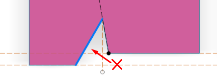

Hello forum:
I'm coming from the Autodesk self-paced learning video series "Direct modeling",
where faces are deleted in different contexts.
In my example,  identical profiles are extruded, each only differing in one angle.
I am deleting the longer, angled face (on the left).
The faces of the front of the body are not on the same height, so I am expecting Fusion to extend the angled face instead of extending the front one.
However, the angle between the selected and opposite face has to be above 90°.  Why is that?
Thank you for any answer
