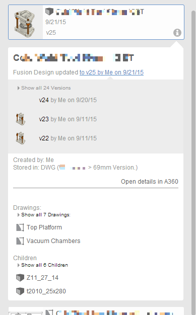

If you lift click the i on the document you should get something like this, I've expanded the versions.
The reason you can't delete the cylinder is one or more of the versions still reference it. If you want to promote an older version at some point it will need the cylinder so you're stopped from deleting it.
One option is as mentioned above, is to use Save As, but you will lose all the versions in the new file. If that's OK Save As with a new name then delete the old assembly then delete the cylinder.
