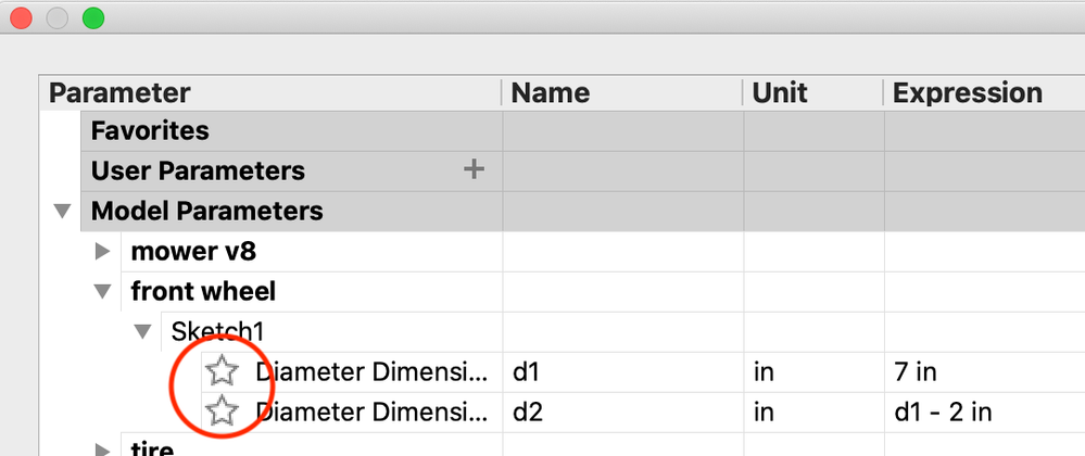

I am a big fan of the new August update! How long have we been waiting for that emboss function? Does anyone know if there is a way to promote the parameters defined on the fly in sketch dimension to the "user parameters" instead of under "model parameters"? It is alot easier to edit a parametric model using the user parameters than having to go in to each feature under the model parameter to change them.

no, there is no way to promote sketch parameters to be user parameters.  However, you can mark them as "favorites" using the star icon, which will bump them up to the "Favorites" section of the parameter dialog:

@jeff_strater -It would be nice if the parameter was automatically "Favorited".  For me, the isn't much use in naming the parameter if I don't intend to use it somewhere else.  currently we have to either magically remember it, or hunt it down in the parameter list and favorite it manually, so it will appear in the drop down box showing available parameters for entry.  easy for a small design, time consuming for a large one.  by the time I do that I might as well just make one from scratch in the parameter list.  would be faster.

Thanks for your reply Jeff! That is definitely helpful to create an overview of parameters driving the design for easy editing. Ideally I would like to be able to promote the parameters I define in the sketch dimension to favorite or user parameters to save more time. Being able to name the dimensions in the sketch dimension tool still speeds up the use of parameters as one is not jumping back and forth between sketching and modify parameters, it just seems it could be made even more time saving.
