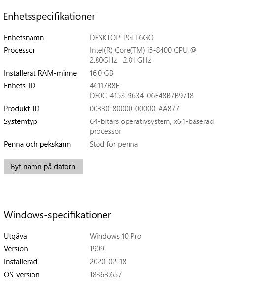

ralliartswe
Hi Phil!
Thanks for helping us!
I'll post a screenshot of my specs here:
Also use a Geforce 970 GTX 4GB.
I caught the problem on screencapture here:
However, my derive-trick didn't work this time. But the cloudrendering shows the decals. I've opened the F3D file a couple of times now, and sometimes the in-canvas rendering show the decals all of a sudden, and sometimes they won't show at all, no matter what you do.
