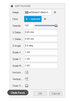

I am modelling an F1 Racing Tyre - not as simple as it sounds.
I am trying to get the Branding in the right place but I am running into issues with Decals.
Because there is a big hole in the middle of the tyre, Fusion wants to put the actual Decal on a surface. This is
fine as my Decal has a transparent background and the only parts are actually ON the Model. Fusion however
tries to wrap all of the Decal around the sidewall of the Model.
Is there a way to drape the Decal over the Model like a sheet? This would put the Decal in exactly the right
place as the centre of the Decal on the Origin would be the origin of the Model. I tried creating an Offset Plane
but Fusion wants an actual Surface. The only Surface available is the rubber tyre.

TheCADWhisperer
@Drewpan wrote:
Fusion however
Did you Uncheck Chain Faces?
