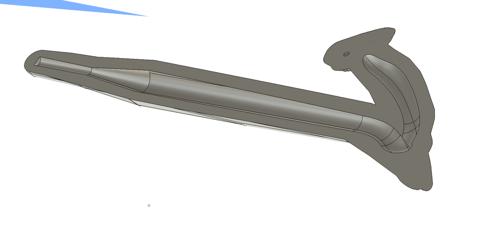

ok, so in fusion 360 I created the shell of an imported complex object (to do so I had to downgrade the mesh, create the shell, then use the cut tool to get the hollow inside) --> now, I want to split it into 2 parts where each is roughly half (so its open, I can combine it to make a mold) --> I am struggling on how to do this in fusion 360

Warmingup1953
Message 5 of 12
e_m_penn
green

Warmingup1953
But such that the split follows the 3D part-line ( if one exists) all around?
Why not employ a Lost Wax method of casting? As one.
Message 11 of 12
Warmingup1953
Actually I think that with a bit of work it will be possible:....The Axes through the extremities cylindrical ends appear to be quite close to where the split plane(s) will be:
