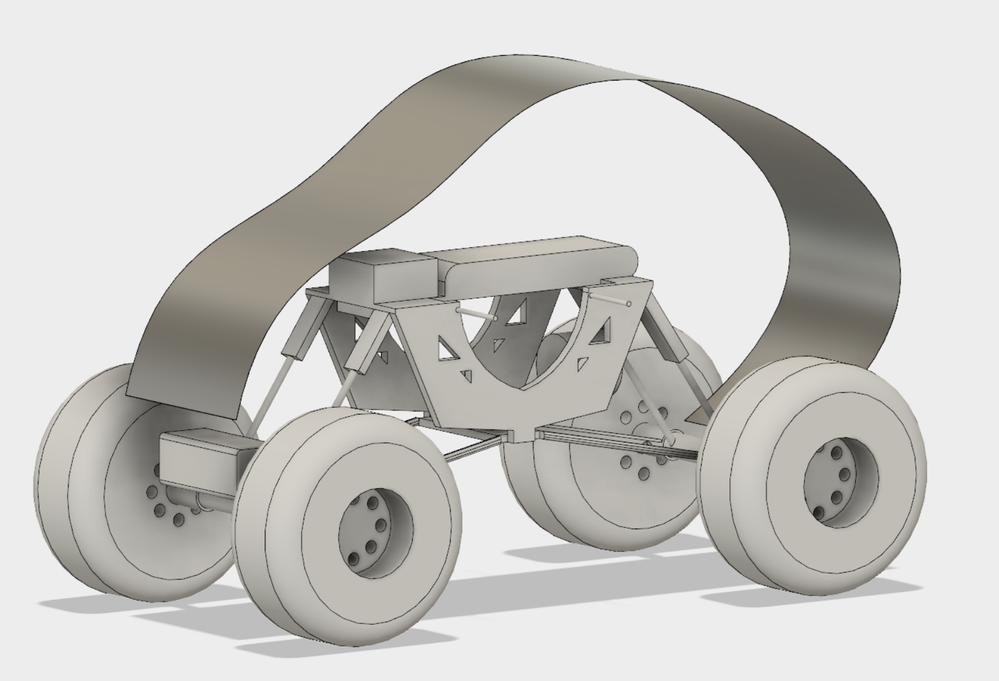

Hello everyone,
This is probably a really stupid question but I'm a beginner so...
I am trying to make a solid body into a 1mm shell. When I use the shell command it works, but it only leaves one side of the body open. I want both sides of the body to be open, but if I try deleting the wall from the inside, it deletes other parts as well. If I try from the outside, it just gives me an error message.
I have photos attached below.
Can someone please tell me how to remove this wall?
Thank you.
15,260 Views
SaeedHamza
When you select the shell command, you select the face/s that you want to delete, so iinstead of picking only one side to remove after shelling, select the other side as well
Saeed Hamza
Got it, thanks!
