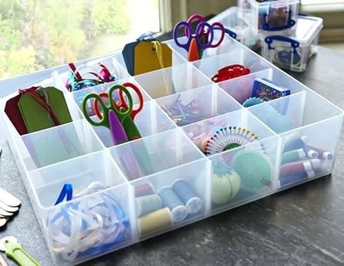

Hi. I have a question about the best way to approach something.  This is very simple but there are a number of ways I can go about doing this, and probably some ways I don't even know about yet as I'm still learning.
Say I have a box, hollowed out with the Shell feature and given a wall thickness of 2mm.  Now let's say I want to add some inner compartments and build up walls with a thickness of 1mm.
Here is an example image of a similar concept for reference:
VCq0z1r
Important to note that my entire model is designed from user parameters and I want to be able to change these values in the future so they can be used to automatically reconstruct the model with different properties.  For example, I define that I want 3 compartments along the X axis and 4 compartments along the Z axis, and then I would use these values in the Pattern feature for example to create other features.  At some point I might want to change those to 5 along X and 4 along Z, or I might want to change the inner wall thickness parameter.  I want nothing "permanent", or hard-coded so to speak
What is the best way to define these inner walls?  I could create solids and do boolean cuts, I could draw out a sketch of one section and pattern it, etc.
I have a secondary question that might relate to this.  I remembered about the official "Thicken" video (here) .. in this video, they seem to have some kind of body that has zero thickness.  How is a body of zero thickness like that created?  How this relates to my previous question is.. I was wondering if it would be possible to do a simple sketch of zero-thickness lines for walls, and then use the thicken feature to build out the thickness.  Hopefully that makes sense.

You are on the right track with parametric body patterns.
There is also the Rib  and Web Tools,  in the modelling area, to investigate.
Zero thickness bodies are made in the Patch / Surfacing area.
So many ways to skin your cat.
Oh wow, the web tool looks perfect.  Thanks!
