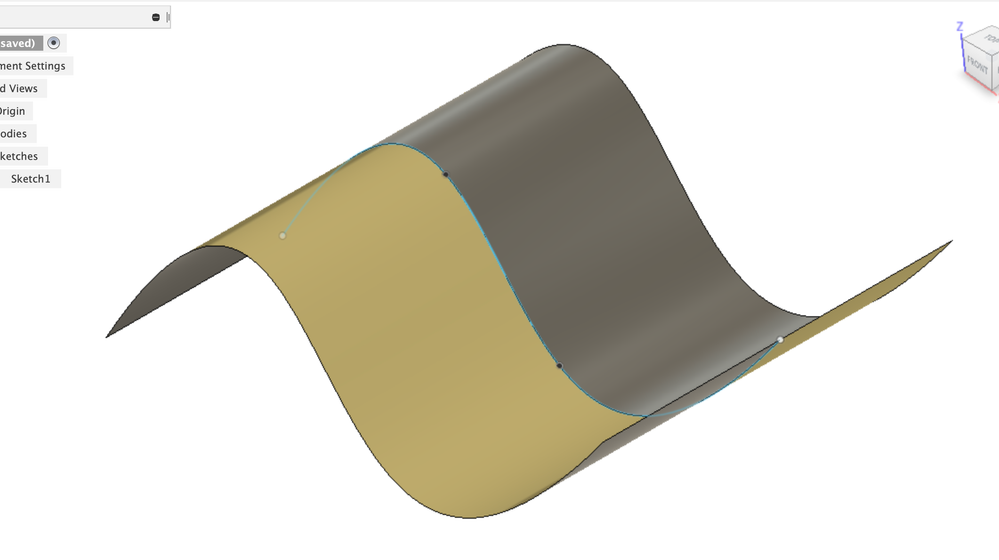

The normal direction is determined by a set of heuristics.  Here is one curve - extrude it one way, normal is up, extrude it the other way, normal is down.
