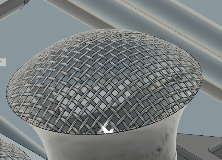

Stain Steel Wire Mesh is creating by using Metal Loom. it looks very impressive & Have a unique choice to improve the visually & Modeling Performance.

amya3326 could you explain this methon in more detail? I'd love to try to model steel wire mesh on my microphone model. I know it will be very computer power demanding task but i think rendered images will blow my mind:)
