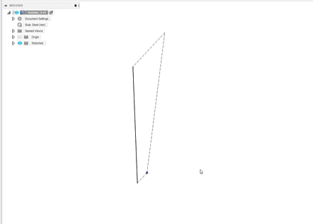

Hi All,
I'm fairy new here, so this is my first post...
I tried looking everywhere for a solution to this, but I am still lost.
I am trying to create a "simple" 90 bend with two cylinders, but the bend is reducing in size towards the upper diameter, or outlet , if you will.
Now, the problem is that I can create the entire loft feature, but I can't get to unfold/ get a flat pattern, or even start by converting it to sheet metal ?
Can someone please advise on how to fix this, I am just looking to get the middle part as a manufacturable flat sheet metal part.
Thanks a lot, I really appreciate all the help!
Dewald.

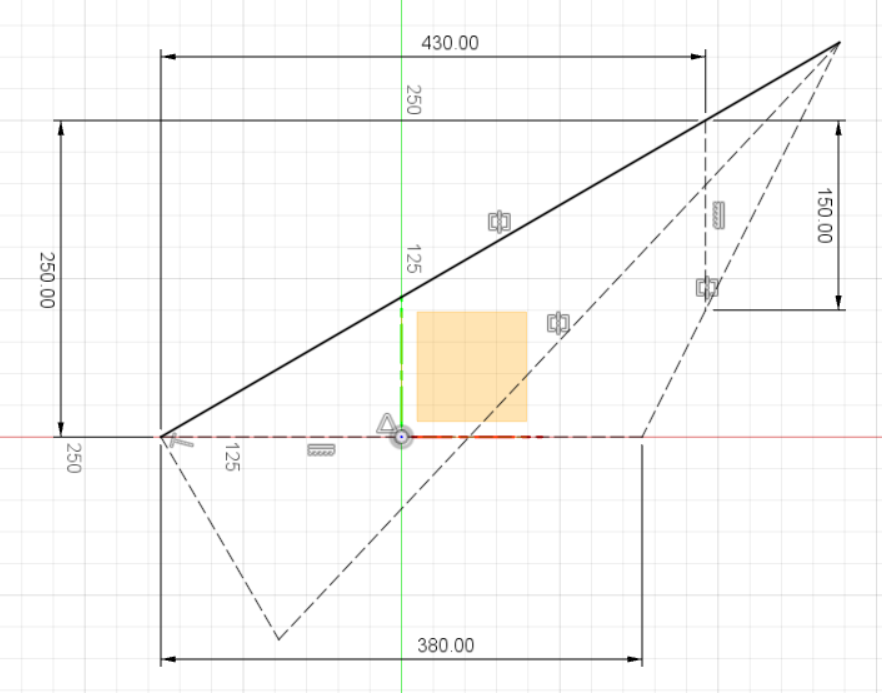

Message 2 of 11
g-andresen
follow the timeline in the f3d file
unfold coneunfold cone
günther

Message 4 of 11
Hi Gunther,
Thanks for the reply,
Unfortunately, I'm still struggling. I've followed the timeline in the sample you sent me, I get the new drawing created,and the contour flange, but when I create the surface revolve, it doesn't want to select the edge of the flange created for the profile of the revolve, see attached.
Sorry, I really want to learn this.

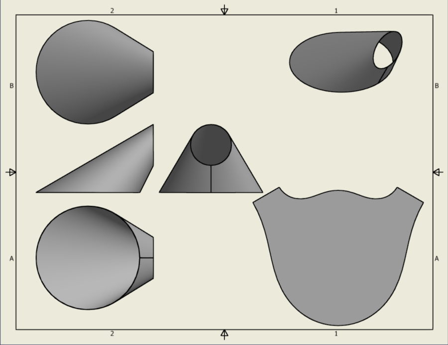

Message 6 of 11
TheCADWhisperer
Hint

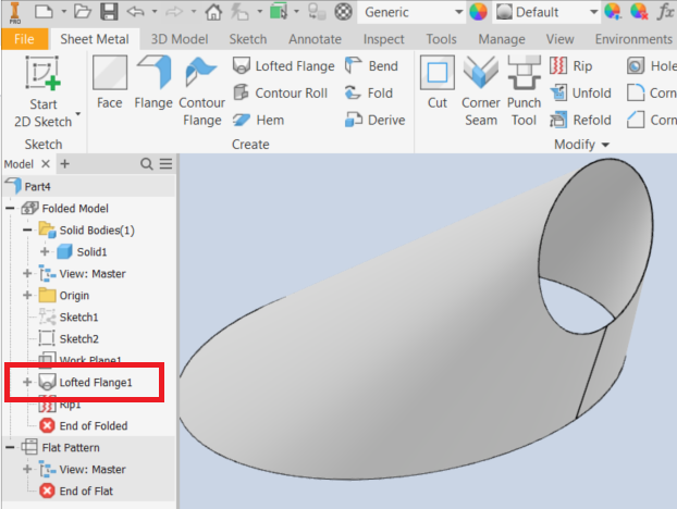

Message 8 of 11
TheCADWhisperer
Ahhhhh, why did I not look at the other views?
This was so trivially easy in Autodesk Inventor Professional that I got mentally side-tracked.
Inventor - Lofted FlangeInventor - Lofted Flange

Message 10 of 11
TheCADWhisperer
@Anonymous wrote:
Thanks a mil, @TheCADWhisperer . I knew this was somehow possible, kudos to you sir.
Hopefully, I will someday be somewhat as good as you.
Check it again - I was wrong.  😯
Message 11 of 11
chrisplyler
Oh it's certainly/easily possible, but not with Fusion 360. Fusion requires that sheet metal bends be either cylindrical or or conical. Your desired shape does not fit the requirements.
As @TheCADWhisperer  showed, it is an easy task in Autodesk Inventor. Fusion isn't going to do it.
