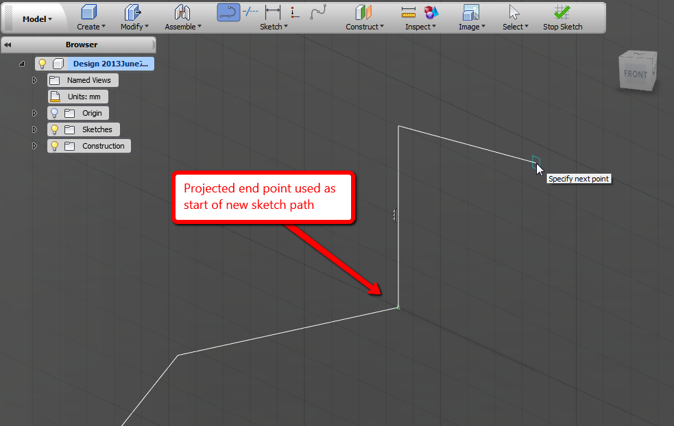

Hi! Thanks for posting.
What you want is entirely possible. Construction geometry will get it done.
Steps:
  1. Create your first sketch
  2. Use Construct > Plane Along Path
  3. Select the first sketch path
  4. Drag the arrow to the end where you want another sketch to start
  5. Okay the plane creation
  6. Start a new sketch on this plane
  7. Use Sketch > Project Geometry to project the end point from first sketch path onto this new sketch
  8. Connect the second path to this point
This process can also be used to connect the sweep profile to these paths.
When you use Sweep you must select the paths in sequence.
Cheers!
