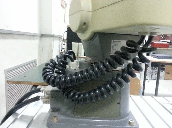

During the course which I followed I made a model of a robotic arm which currently sits in a school lab.
1.pngOne part of the mechanical arm has some electrical cables with the shape of a spiral.
In the construction of the model, I left this detail for last, thinking that Fusion would provide for tools to handle the modelling of the component in a simple way. Then, I found out that this could be done only with other Autodesk software (3DSMax and Inventor) which I did not know or with software from competing companies (Rhino and Solidworks), not with Fusion. So I tried to develop a script which may help.

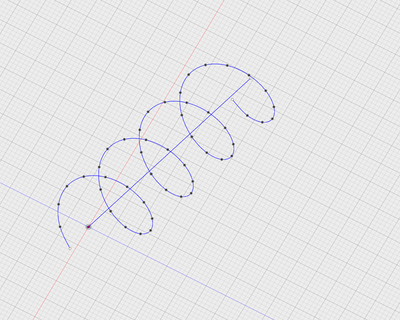

The starting step of the construction of the helix is to choose a curve which represents its revolution axis.
Its length defines the helix dimension and the starting point of the curve defines the plane from which the helix starts. In the picture, I have chosen a linear axis for simplicity.

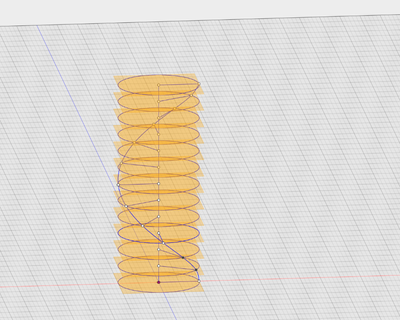

The software is based on the construction of successive planes built orthogonally to the axial path. This can be simply linear or can follow a spline.
3-Spline.pngThe number of planes depends on the number of points chosen to define one cycle of the helix.
The planes are built using the following code:
planeInput.setByDistanceOnPath( sketchCurveOne, offset )
planes.add( planeInput )
The offset parameter defines the distance of the plane from the origin of the path and equals 0 on the first plane and 1 on the plane corresponding to the last point of the helix.
On each plane I drew a sketch containing:
- a circle which has the same radius as the helix
- a line which origins from the revolution axis and gradually rotates as we go up from one plane to the next one.
The intersection of these two elements defines a series of points which, joined by a spline, build the 3D helix .
The number of points of each helix cycle is defined by the user and is fixed to 12 as a default value. According to this value each line, belonging to one plane, is rotated by 30° to the line of the previous plane.

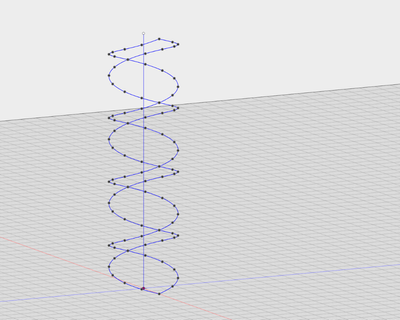

A double helix around a spline which resembles the DNA double helix | Helixes with variable starting angles

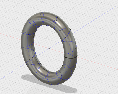

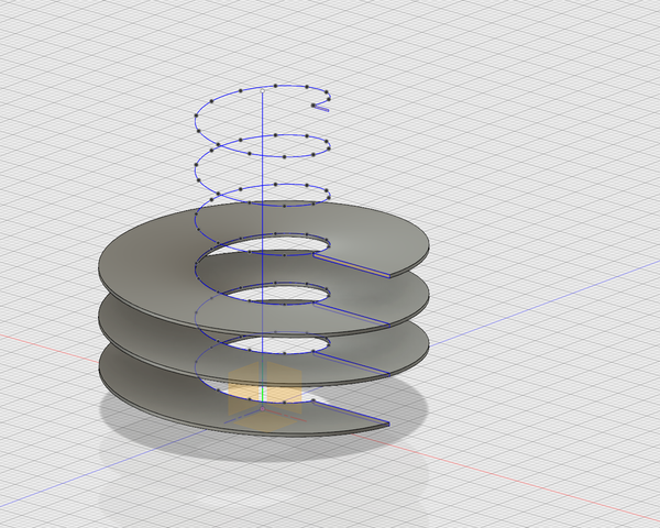

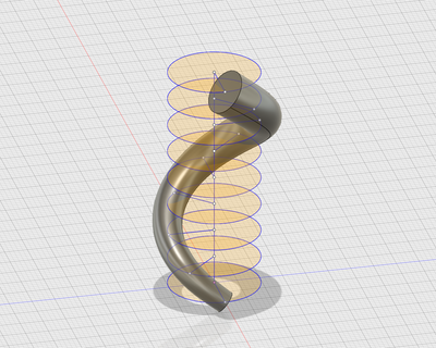

The helix can be used to build something more complex using the Loft function
An elliptical toroid built inside the helix which is built around the toroid axis. The toroid was built from the starting and final helix construction sketches
using the Loft function. Note that the toroid is open!
A helicoidal ramp starting from sketches in succession for each helix cycle that are references profiles for Loft sequencing operations
The add-in structure allows to make two vertically unaligned helixes which can be used as a path for a construction on a vertical plane, using Loft.

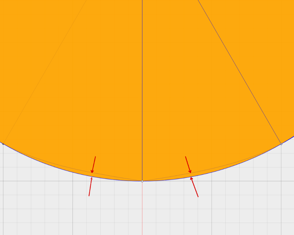

In the first and last part of the helix there is a gap from the circular path which needs correction.
