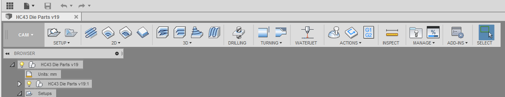

HughesTooling
Quote from update page.
"Fixed – Autumn.S reported a really annoying workflow where if he changed the selection filter in the modeling workspace and switched to CAM, he wasn’t able to change the selection filter in CAM and had to go back to Modeling to make the change. Now you can do it right from the CAM workspace."
I don't see this, it seems like when you switch to the CAM workspace all filers are switch on! If this is correct that's worse than before as now there's no way to filter just edge selection, it was a pain before to have to change to the model workspace to set filters but just having them all on all the time isn't a good idea.
Here's a pic of the toolbar in the CAM workspace, notice no option to change filters or am I missing something. One more question, I'd not thought about this before but why is the selection icon there at all, if you click it while setting an op up it just cancels whatever you're doing an closes the dialog!
Mark
Mark Hughes
Owner, Hughes Tooling

keqingsong
Hey @HughesTooling, thats for bringing this up. Let me dig into this and get back to you. Not sure what happened here.
