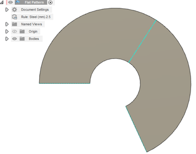

TheCADWhisperer
Lofted Flange
Sketch1 is not fully defined?
Cut edges not perpendicular to the flat?
Surface body?
Edit the Sheet Metal Rule to the desired Thickness.
Edit the Rip parameter to desired gap.
jhackney1972
I have created a quick Screencast to show the process.  Everyone has their own method of creating the slit in the side, I use a sketch arc.  Other than that, the new Lofted Flange tool makes it a snap.  Model is attached I used in the Screencast.
