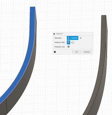

@MrX2111 wrote:
... sketch it creates looks to be just a profile and not editable even though I can select the edges and points when hovering over them or right clicking...
That is happening because you have this (by default) in your preferances-
which projects the edges of the body as sketch elements into the sketch, but AD chose to make those projected elements invisible to, quote "reduce clutter".  I've lost track of how many people this has tripped up over the years.  and if you ever create a sketch on a face that has a bunch of edges you can even crash the program, or at least make it laggy.
I HIGHLY suggest turning this preference off,  and discreetly projecting into the sketch what you need to use as @g-andresen describes.

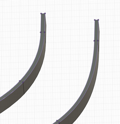

Let me use a real use case which I am working on. The attached file will have an object that looks like 2 ribs. How would you cap the top like the photoshop file I attached "ribs capped". "ribsA" is the before.
PS: I checked the setting and auto project geometry is not checked.
Message 10 of 20
laughingcreek
when ever possible, you want to refer back to originating geometry, in this case the sketch.  see attached model.
There is also some weirdness going on with that first sketch, you have curves laying on top of each other in both ribs-
Also, curvature quality will suffer when you use sketch offset on a spline.  I suppose not a problem here, but will be when are doing surfacing work with lofts-

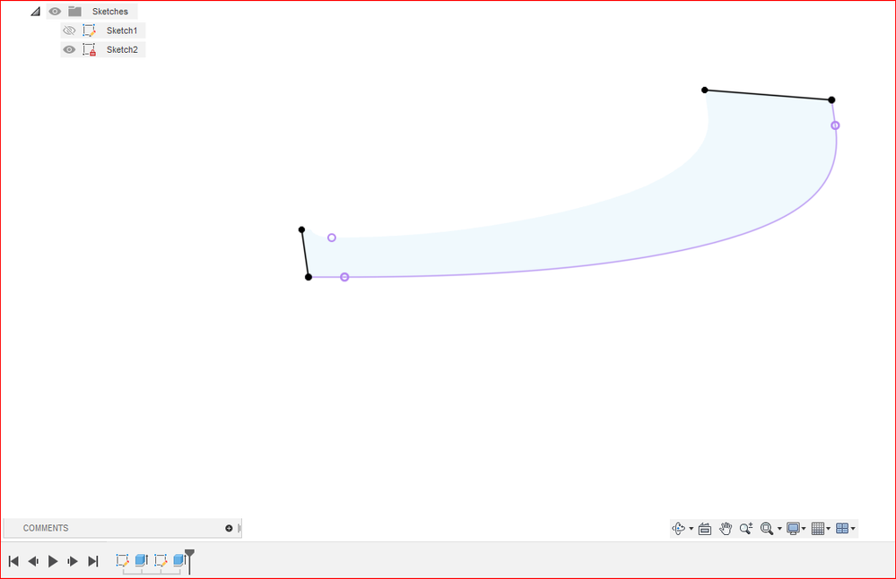

You selected the top of one body to make the second sketch.  That body is / was projected to the sketch, only blue profile is visible when you hide the body.  (I also broke the original profile with a line changed to construction)
To successfully place a cap over the 2 bodies, you project the outer curve of the other body, and close the profile for the top plate.  Extrude this to height required.  I joined it to both ribs in the Extrude process.
Added black and purple lines to your sketch.
Might help....

The purple lines in the sketch are the result of Project > Project.  Linked to the outer curve of sketch 1, so edit sketch 1 will update the purple lines.  The black lines connected automatically to the original shaded blue boundary corner points, (end point of invisible lines, mouse highlight them to see them) and the purple end point/s.
Bunga says project the second body but that brings in more purple sketch articles that you didn't need, to make a top plate.
Might help....
