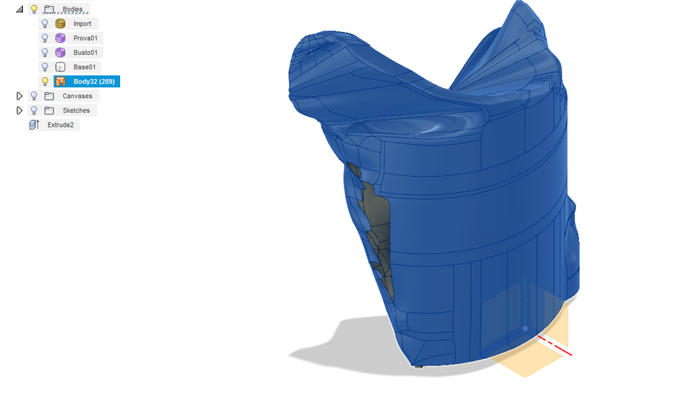

Hello to all,
I'm new on Fusion 360 and would like to have a help in following the right workflow to accomplish a little task.
I should create a support for an irregulat ornament. It's a hollow torso ornament.
Actually i've not an image with me, but is simple to explain, I hope!
It's formed by a cloack on the shoulder and down to the back and a head. So the front part is missing (the torso), so the ornament is going to fall forward.
I need so to create a support that fills the torso creating a structure. I don't need to recreate a body (toooo complex). A structure is enough, that should have then a cloth (wave) effect on the front.
Having a missing torso, I'm able to measure the distance from the end of the cloak to the inner shoulders in many points. that should give me different measurment points. After that I should concat all those points to create the upper support line. So I should have a box that fits the upper side.
After that, I should apply a wave/cloat effect on the front.
Hope I've explained the task I need to accomplish.
Any help, Idea?
Many thanks!

mavigogun
It sounds a task more suited to Blender.     If Fusion is the only option, I'd create a figure-shaped former in the Sculpt workspace, finished to a BRep Body, then follow with a fresh Sculpt to create the rippling cloth, using the previously contrived Body to conform to.    If naturally draping cloth is your goal, anticipate a great deal of tedious work.    As upside, if persisting, you'd have a solid grasp of what is possible (or not) in the Sculpt workspace.    You might also experiment with Converting the product to a Mesh for smoothing- I'd like to see what utility those tools might present to the task.      In any case, your foe will be self-intersecting surfaces preventing a finalized, commutable form.

TrippyLighting
There are no automated, or semi automated ways to "simulate" cloth like that can be done in Blender (and really is not that difficult there either).
However, if you are not shy of doing a little bit of manual modeling work, this can be done with T-Splines and has the advantage that in the process you'll learn a now tool in Fusion 360.

xefil
Hi all,
I was able to make some tests and now I'm blocked in my workflow.
Trying to convert the mesh to a body, I've got some issues on intersected faces. Deleting them all, I was able to convert it, but the result is an emply body, not filled.
From here:
To this:
It's due the t-spline/mesh body is not closed?
How can I close it? The fill hole or bridge is not working well and it causes other incersections on faces.
Isn't possible to design the faces manually? The vertex that are not connected to nothing (design in an empty space) are not designed.
Thanks!

VladimirPudding
Marvelous Designer/Clo3D more up your alley. Also, Blender can do this now, so can Houdini, but still not better than MD/CLO. You could do it in ZBrush too. I don't know why these people didn't give you those 3 solutions. Tunnel vision, perhaps.
