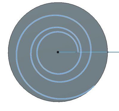

sherinedias
So with this method the line shows up on on the object. But now what if I want the object to be cut along that path! Oh n let’s assume tht the object is hollow with a wall thickness of let’s say 1 mm. Achieved by using shell command.
Message 17 of 20
sherinedias
So I get that line! Now I want to use that line and split the object! How do I achieve that?? Assuming the body is a hollow body of 1 mm thickness using shell command. Using ur method I have sketched everything! Now I just meet to split the body.
Message 18 of 20
sherinedias
So I get that line! Now I want to use that line and split the object! How do I achieve that?? Assuming the body is a hollow body of 1 mm thickness using shell command. Using ur method I have sketched everything! Now I just need to split the body.

etfrench
Attach your file to make it easier to understand your question.
ETFrench
Message 20 of 20
sherinedias
Thank you so much!! But I did put it up on Reddit and I got my solution!! I’ll attach the post for you here https://www.reddit.com/r/Fusion360/s/TWh6BLCUWQ
