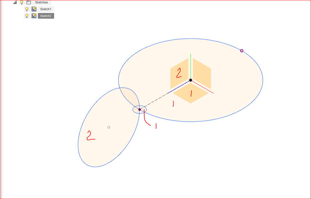

davebYYPCU
Sketch plane for the path is easy to create with Plane on a Path, or maybe the model is able to use the origin plane.  Sketch 1 has Sweep Path. then another Sketch for the Sweep profile,
Maybe the Pipe tool can be used, to make things easier.

davebYYPCU
When / if you use the origins as provided, you place the two circles that I marked 1, on the flat no 1 plane.
Then on the no.2 plane sketch the sweep path (2) to use with the small circle.
The small circle is cut in half by the big no1 circle, so select both when selecting the Sweep profile,
Might help....
