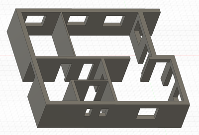

I created a 3D model of a house:
How can I convert this to a 2D drawing, so that the dimensions of the windows and doors are also in the drawing? I'm only able to create this drawing without the dimensions of the windows and doors:

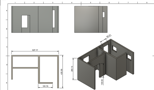

@Anonymous,
Create a Drawing and you can give dimensions in the Isometric view also..!!
Attaching the Model and drawing file for your reference..!!

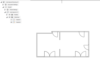

Bunga777
You can write doors in the sketch and make them visible in the drawing.
Here is a small sample of what I wrote.
The file is also attached for your reference.
