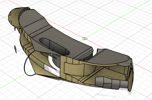

Hi all:  I'm having a problem converting an STL mesh to solid body (no mesh).  The STL mesh is attached here which was generated in Tinkercad.  In Fusion360, when I right click on the body to see properties of the mesh body, I see no issues (see attached property list).   I used the following convert process in Fusion360 with no luck:
1) Generate Face Groups, select "accurate".
2) Modify, convert mesh.  I select "parametric", and "prismatic".
For Generate Face Groups, I have tried boundary tolerance of 0.001 mm and 0.1 mm.  Both result in failure.
I get warning:  "convert mesh", and "compute failed".  The resulting image of part has missing sections (see image).
Hoping the fix is something simple.  Any help would be greatly appreciated!

thanks @TrippyLighting. It will take me a while to become proficient in designing using Fusion360.  I was just hoping for an easy way to simply convert STL mesh to non-mesh solid body, with same dimensions & accuracy.

There isn’t any accuracy in stl.  Any conversion of planar triangular facets into curved faces involves interpolation.
