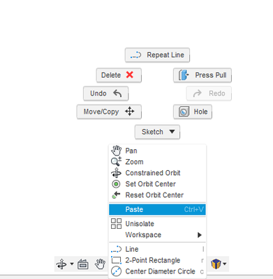

It is possible. right click on the bodie
and in the file you want the bodie, right click on the name
For sketches is different. Right click on the sketch and edit it.
Select the sketch and right click on it
In the design you want that sketch, create a new sketch. right click and paste. (keyboard command works too)
and there is your sketch. you can move it whereever you want. Just click on ok and that's it.
