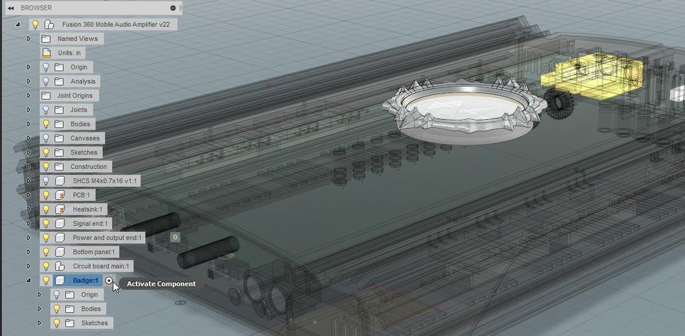

To make this work you must follow the best practices for assembly modeling. Specifically, you must have from the start used this workflow:
1. Create Component (RMB on the root of the browser)
2. Activate component. See below.
3. Create all sketches and bodies inside this component.
Otherwise, what happens is Fusion will deliver pasted components without parametric information. You can still add features or modify them, but the sketches will be gone.
The other benefit, aside from Copy and Paste of parametric components, is that this kind of workflow allows you to filter the timeline for each component when you want to work on it. See below.
