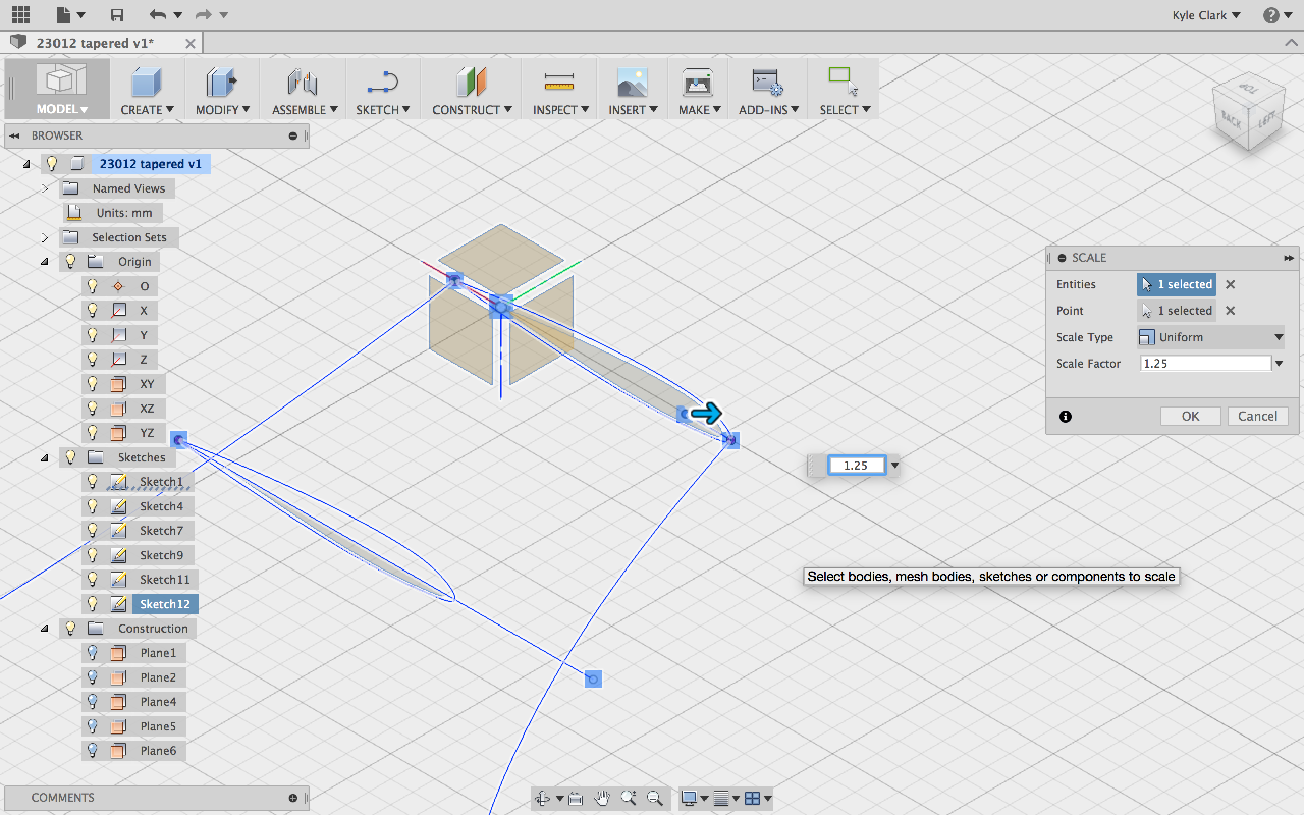

Hi everyone,
I'm trying to make a series of profile sketches on paralell planes to loft between.
I have sketched the profile on the first plane, offset a plane and started another sketch.
When I copy the profile from sketch1 on plane1 and paste it on sketch2 on plane2, I would like to scale it.
The problem is that BOTH profiles scale... I don't see any option to "break link" when you copy and paste.
Any ideas would be super helpful!  Thank you, -Kyle
(my only work-around yet is to extrude the first profile, project the face, break the link and then scale it independently...)

Pasted sketch geometry should be independent from the original.  There is no link that I am aware of.
Here's a screencast of how to copy/paste geometry to a new sketch and scale it, then loft between them:

A couple of observations about your design:
1.  It is a Direct Modeling design (that is, no parametric design history).  You mention that this is an imported design, which explains why.  All imported designs in Fusion are Direct Modeling.  You can convert by choosing the "Capture Design History" command.  This won't create any design history for geometry already in the design, but it will for newly created features
second, the sketch called "needs scaling" can, indeed be scaled, but you will have some problems with it.  The point indicated is constrained at the origin, and the curve is "fixed":
If you "unfix" this point, it can be moved.  However, because that curve is imported, it is not a native Fusion curve, so you will have trouble editing it.  I would re-draw this curve - it will make everything much easier, I believe.

OK, Jeff, you guys have awesome support.  Last question on this thread... I was able to find a post about data points from a script to create a spline and it worked well...
Now I can't scale that either.  Is there a more appropriate way to import a bunch of data points for profiles?  I "unfixed" the data points, but that didnt seem to help.
Again, apprecaite your help!  Please see attached file.
Best, -Kyle

I think I know what's going on, but I'm not completely sure I am solving the correct problem for you.  I'm glad that you found that script to create a spline from point data - while I haven't used it myself, others have found a lot of value in it.
I think you have correctly identified the problem - the curve and points come in "fixed" from this script.  I was able to "unfix" them, and it worked OK.  Part of the problem may be that you have overlapping sketches, but I'm not sure
Anyway, take a look at this screencast and see if it helps:
Jeff
