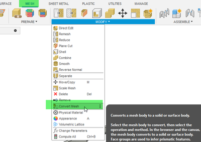

g-andresen
@Pylonbob wrote:
Is there any way that I can convert a mesh body to a solid body using a personal use license?
yes!
günther

TrippyLighting
The only option in the free subscription is the Faceted" version:
Depending on the mesh, however that might not result in what you want, or might not work at all . Not all meshes are created equally.

Message 2 (the first Reply in this discussion) shows how to convert this to a Solid Body.
Message 20 of 26
rex_wrx
TheCADWhisperer,
Thank you for your reply,
However: The tool shown is NOT part of the FREE (Personal) version of the software.
