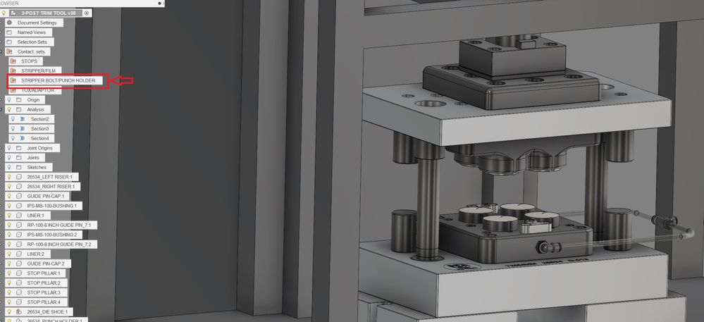

Good Morning,
I have a contact set that doesn't want to behave properly.  Anytime I suppress, or enable/disable, the contact set, it inadvertently picks a different body than what was intended.  The same behavior happens when I open/close the file, save, edit, and even intermittently.   Please see attached screenshots for details.
Thank you.

Yup. The implementation of Contact Sets in F360 is pretty sketchy. If you can obtain your desired behavior with Joint Limits instead, as I suspect is the case in your scenario, you will be much better off.
