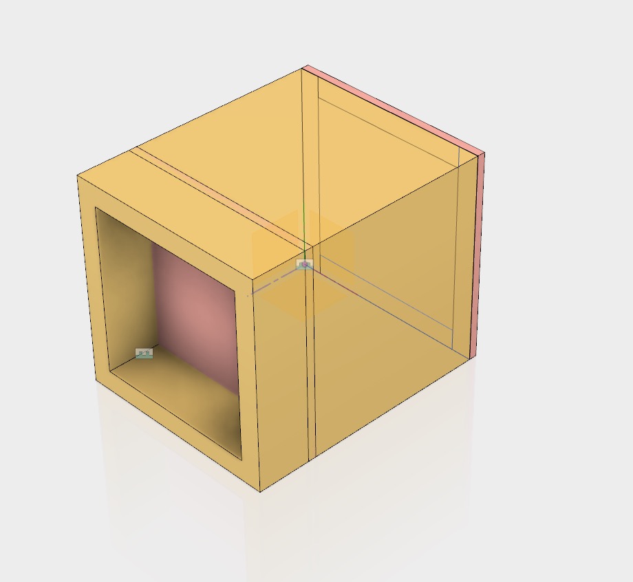

Please see both the attached f3d and the attached screencast.
Trying to make "Component 1:2" move along the Z axis when I change the user parameter controlling "Component2:1" size along Z.
Have tried applying a rigid joint between the two. Nope.
Have searched the web for controlling component locations with user parameters, but all I seem to find is how to control a specific component, not a component in contact with the one being controlled.
I think I just don't know what to search for. "Ya don't know what ya don't know."
Searching is very hard due to my inability to memorise all the Fusion terminology.
To me it is "How do I make this component stay glued to the front of this other component when I make the other one wider?"
LOL. Not useful for Fusion's many many names for ways to make thing stay stuck to other things.
I am guessing that maybe I can control an offset construction plane's distance from the origin plane with that same user parameter and somehow lock Component1:2 to that construction plane?
I did read plenty about using sketches to control locations, but that doesn't seem to apply to this situation.
I KNOW you can do this. I just can't figure out how.
Please:
What is the best way to make  Component1:2 stay stuck to the front of Component2:1 no matter how much Component2:1 grows or shrinks along the Z axis?

Create a rigid joint between Component1:1 and Component2:1 and another between Component1:1 and Component2:1.  Ground Component2:1.  Modify user parameter at will Smiley Happy

drew
See attached screenshot for the results of:
Begin with user parameter at 90
1)create rigid as-built joint between Component1:2 and Component2:1
2)ground Component2:1
3)create rigid as-built joint between Component2:1 and Component1:2
4)alter user parameter to 120
Still leaves Component1:2 in its original location.
Did I misinterpret or follow along wrong?
(edited to increase clarity of steps)
Message 6 of 10
drew
AH-HA!!!!
You can't just create ANY rigid jpoint!
It MUST NOT be an as-built joint.
A "Rigid Joint" and an "As-Built Rigid Joint" are NOT the same thing according to Fusion's internal logic.
Note: This is not at all apparent to a user, since there seems no difference in the names other than the idea that "in as-built I don't have to move any of them to say where they go" and in normal joints "I tell it where it should be because it may not be there right now".
But whatevs. I'm in the minority of users that struggles with the nomenclature.
So, etfrench is correct but I think he assumed I would understand he meant a specific type of rigid joint. Assumptions when the names for joints are so similar make for confused novices.
Here is the process that made Component1:2 move when the user parameter controlling Component2:1 is changed:
Begin with user parameter at 90 (or whatever your starting value is)
1) Ground Component1:1
2) Create rigid joint between Component1:1 and Component2:1 -  Either 'as-built' or 'standard' joints will work.
3)Create rigid joint between Component2:1 and Component1:2 - this MUST NOT BE an as-built joint
Alter user parameter, and gleefully watch Component1:2 shift position as it needs to!
Thanks @etfrench !
Want to mark yours as answering so you get credit, but I am worried that if I do that - anyone finding it will follow you literally and not note the significance of my additions about joint-creation types.
How do we address that?
