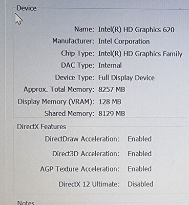

TrippyLighting
Can you share more details about your existing computer?
What graphics card does it use?

jasonfazio
Thanks for getting back to me. The current laptop is a HP Zbook 14u. i7 - 16g ram, 1 tb ssd running Windows 11 HD graphics 620.
