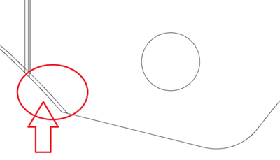

The cut edge is not perpendicular to the flat in this area...

nathandiclaudio
Good catch, I just checked and the original STEP is that way.
That is my mistake. It was created because of how I went about modeling it and didn't notice.
I was too wrapped up in thinking the radii was the issue to see it.
I'll repair that and try again.
