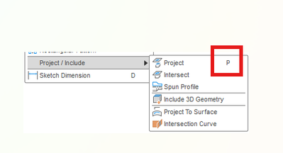

I am looking for a way to constrain a sketch feature (in this case a circle) to a component in the assembly.
This is a very simple task in Solidworks where most of my experience comes from but I can't seem to make it work in Fusion.
I have two inserted components from the manufacturer and I want to make a circle I created in a sketch concentric to the circle in their inserted component.
See attached screenshot
357 Views
TheCADWhisperer
@andrew5HX2X
It is hard to tell from your screenshot, but my first thought is hit p on your keyboard for Project (geometry) and select the geometry you want tie to.
andrew5HX2X
Ah, this did it! Thanks so much
