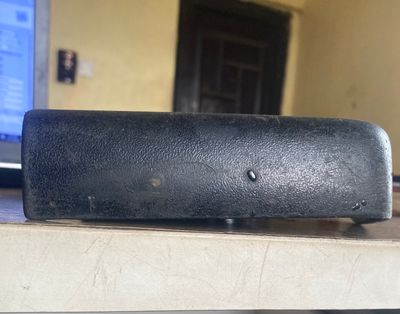

As it appears, I’m not great at hard surface modeling, but with the few questions I’ve asked here, I’ve been able to up my skills. But, I’ve hit another wall with a model, and I’m hoping that I can be helped with figuring this out.

Please don't double post the same question.  (Stay here now unless others answer the other question)
Please confirm the dimension I asked about.
Your pics were taken flat and horizontal on a table surface - front on.
Why are they not like that in this file?
Point to point top pic outside on table dimension, is that about 158 mm or something else, without this confirmation, we will be stuck.  Size is first important detail.

I’m sorry. I just got desperate. My head was spinning and nobody was answering me anymore. Well in the file, I didn’t make it flat because I wanted the front view to align with the top view(ontop of the front view, if I did otherwise, the top view would be under the front view which would affect the side views since it’s obvious that using an offset on the side views would not work since both sides are not perpendicular to the top view, so the plane of three points would be more efficient there) hence the front view seeming slanted. So if I did otherwise, the top view wouldn’t really be syncing in the real sense.
I don’t know if I need to take a video of the model itself.
also the images are all calibrated, and I’m sure I dimensioned some of the lines in traced out. Also the point to point calibration of the top image is 160mm. The front view almost same. It’s 159.2.(this is because of you take a close look at the image, one of its ends is curved, instead of a more perpendicular edge to the top) this is why the point to point calibration of the top and the front view differ by almost 1mm

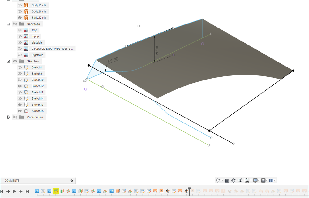

I put the origin in the middle of the top sketch line at table level.
The straight line trace of the foot print is shown.
Put the bottom sketch on a Plane at Angle, and traced the bottom canvass.
I need the top of model height off the table, and the bottom outside lower heights - as close as you can get them, I know they are in 3d space.
The 2 blue flat curves are for the top inclined face top view.
Surface > Loft the imaginary floor.
Traced the actual footprint off the canvass and cut the floor with Surface > Modify > Trim.
Tracing the left canvas - extended the top line to the top sketch.
In the top right hand end of the top sketch, there's is a short flat area, and that line is continued to the left sketch.  Loft this line to the back curved top line in bottom sketch.
Trim this part of the top face with the rear curve in table sketch.
Part 2 to follow, gets a little complicated.
Might help...

The top sketch has a small curved face line.  I did a new sketch, using the side curve to get the left end of the top profile to align. Loft from it to the inclined line in the side sketch, with the top face curve as centre line rail.
Then a new Loft from the long black curve to the bottom curved edge of the previous body.  Hide the inclined body.
Loft from bottom face curve to top face curve, and tangent both selections.
Stitch the 3 bodies together.  Then with the top fillet outline curve, trim this body.
You now have the dummy floor and the top faces, to create the wall sections
I used 6 wall profiles in 3 lofts to save Fusion getting to confused.
Created the side walls with top and bottom body edges for rails.  All 4 sections thickened to 2 mm, and 2 of the sections did combine with top plate, but the back one fails.
As none of my dimensions would be suitable for you, using your dimensions where you can.  As said, I ended up manipulating the canvasses to get this close so they are no longer original either.
Happy to answer questions.
