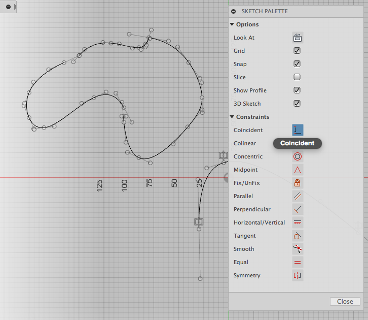

1.  how do you join a bunch of little splines into one
Can you provide me with some more information about what you are trying to accomplish with this workflow.  What is the reason for seperate little splines?
To combine splines use the coincident constraint on the ends of the splies.

thanks Mike.  I am trying to patch a revolve but nothing I did worked so far - how do i create a solid after i patch? combine didnt work
how can i make sure i created a closed solid polysurface?
bob_holland
Autodesk Support
Autodesk Support
skazmdesign,
This is assuming that the user is associating polysurface to T-Splines.
The easiest way it to convert to a BRep:
       http://knowledge.autodesk.com/support/fusion-360/learn-explore/caas/CloudHelp/cloudhelp/ENU/Fusion-F...
If a T-Spline will convert to a solid, it is closed.
If is converts to a surface it is not closed.
Please let me know if this does not answer your question.

San_Escobar
Hi skazmdesign
I have learnt something. The meaning for cantankerous
cantankerous = Make you go insane, willing to hammer the computer. lol lol lol
So, I tried to put together a simple screencast here for you, showing:
Join 2D geometry, its won’t become one single spline literally, but will behave like one
To delete a Spline point just select the individual and hit delete on your keyboard.
Can you mirror spline? Sure you can. Just need an extra Linear Axel, 1st select your profile* then 2nd your mirror point (Linear Axel)
* To Select and Unselect make sure your mirror dialog box has OBJECT highlighted. No secret no tricks.
Once you close your geometry, it’s simple to find out if the loop is close or not, it’s become YELLOW. Then you can extrude and so on.
What do you mean, what kind of Poly-surface are you after?
HTH. Happy Modelling
