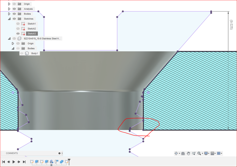

Hello! I'm working on a simple project that incorporates a standard hex drive, countersink metal screw from McMaster-Carr, part 92210A619. This is going into a ¼" piece of metal. And I have two questions: how do I check if the screw will fit flush given my design of the receiving hole in a metal plate; and how can I be certain that a part with a tapped 3/8-16 hole, affixed to the underside of said plate, will have no gap or wiggle/rattle? I've inserted a 3d model directly from McMaster-Carr into my model, and have attached it here. Thanks for your help!

davebYYPCU
I have no access to the file at the moment.
Install the screw into the plate with Joint and Contact Set, for seating, with section view,
check that the full working depth of the thread as supplied is available below the plate,
could be the run out of the thread will not secure a tight fit.
Might help....

davebYYPCU
Don't assume anything, measure it.
You bolt has quite a lot of interfering transition between the lower countersink, and usable thread.
The interfering face highlighted blue, will / does / must interfere with the bottom object thread.
Creating a section sketch allows for the top of bolt to top of good thread, to be measured, and it is 9mm.
File updated.
Might help.....
