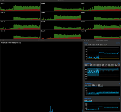

so i've been playin around a bit on my 6core/12thread core i7-8700 with generating toolpaths to see how the cores are used. Have to do a comparison on windows but at least on mac the multi cores and multithreading are pretty well used for toolpath calculations but overall compared to rendering none of the cores/threads are working full steam. did a ridiculous adpative clearing operation on a large complex 3d object with stupid small stepdown and no rest machining (machining this would have been 13h machine time 😂) for analysis.
In the beginning before the toolpaths start drawing this is how it looks:
Start calculationStart calculation
then towards the middle when the toolpaths start drawing:
Toolpaths start drawingToolpaths start drawing
and it fizzles out a bit after that when most of the toolpaths are displayed:
when rendering the same object however it's full steam ahead on all pipes:
RenderingRendering
i think the GPU activity monitor can't be trusted since it's a hackintosh and this particular graphics card is not really supported.
so i guess the graphics card question (iGPU or discrete graphics card) is only partly relevant and hopefully the newer gen cpus built in graphics will all be able to at least run Fusion (since i won't be modeling or rendering at all on the laptop but only pan around the model a bit).
I forgot to run some test of simulating which would be usefull on site as well, but i think i'll switch to Windows to do these tests again ehich will be more relevant.

A good test for core utilisation would be create a setup with roughing and finishing ops and regen all the ops in the setup. Don't use rest machining because Fusion will wait for previous ops to finish.
When you say test simulation do you mean in manufacturing? Sim seems to be mostly CPU, very low GPU.
Do you work with appearances and all the visuail bells and whistles enabled? I don't like working with any of that, just press Ctrl+N for colour cycling and everything turned off. Just testing on an old PC with a NVidia GTX 660 with a fairly big assembly (for me) and don't see more than 20%  most of the time. If I zoom in so the model takes up the whole screen it gets upto 50% but you don't tend to work like that. Weird thing is while moving the model around the CPU jumps to max boost!
