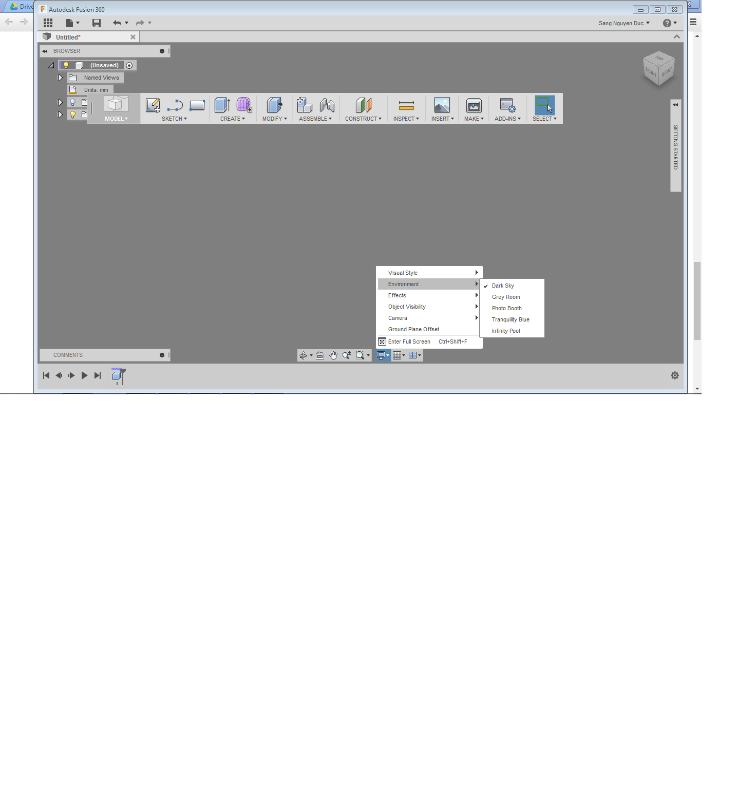

excuse me, i am a new designer who getting the first time to use the fushion 360. And i have a problem that annoy me for some days. That is my backround color is dark which make me can not anything i draw. so how can i change it, like white. hope u help me soon. many thanks. Please contact and give a some advance by Gmail: nguyenducsanggttp@gmail.comCapture.PNG

Hi, Autumn. It is very glad when you give me solution for my problem. But when i carried out, it did not work. That color was still dark like the follow picture. I suppose that maybe the reason is the version of fusion 360 i using is trial version. I hope that there is any way to solve my issue. Hope you read and reply me soon. Thanks a lot!
The color of background i hope i can see in my fusion 360 is white like that so i can what i drew.

Am surprised you have not tried Display Settings >"Infinity Pool" which brings you the white back ground you are after, or as white as your monitor allows.

One last comment. I first sent a message in this group because I thought none of the environments had a white background, including 'Infinity pool', which is in fact white. The reason was that although I had set 'infinity pool' I had the 'ground plane' (under 'Effect's) active as well. Depending on the camera angle, the background seems to be gray. That was what confused me, but once I unchecked ground plane, the background is always white. I hope this might help. Cheers, Roberto R
