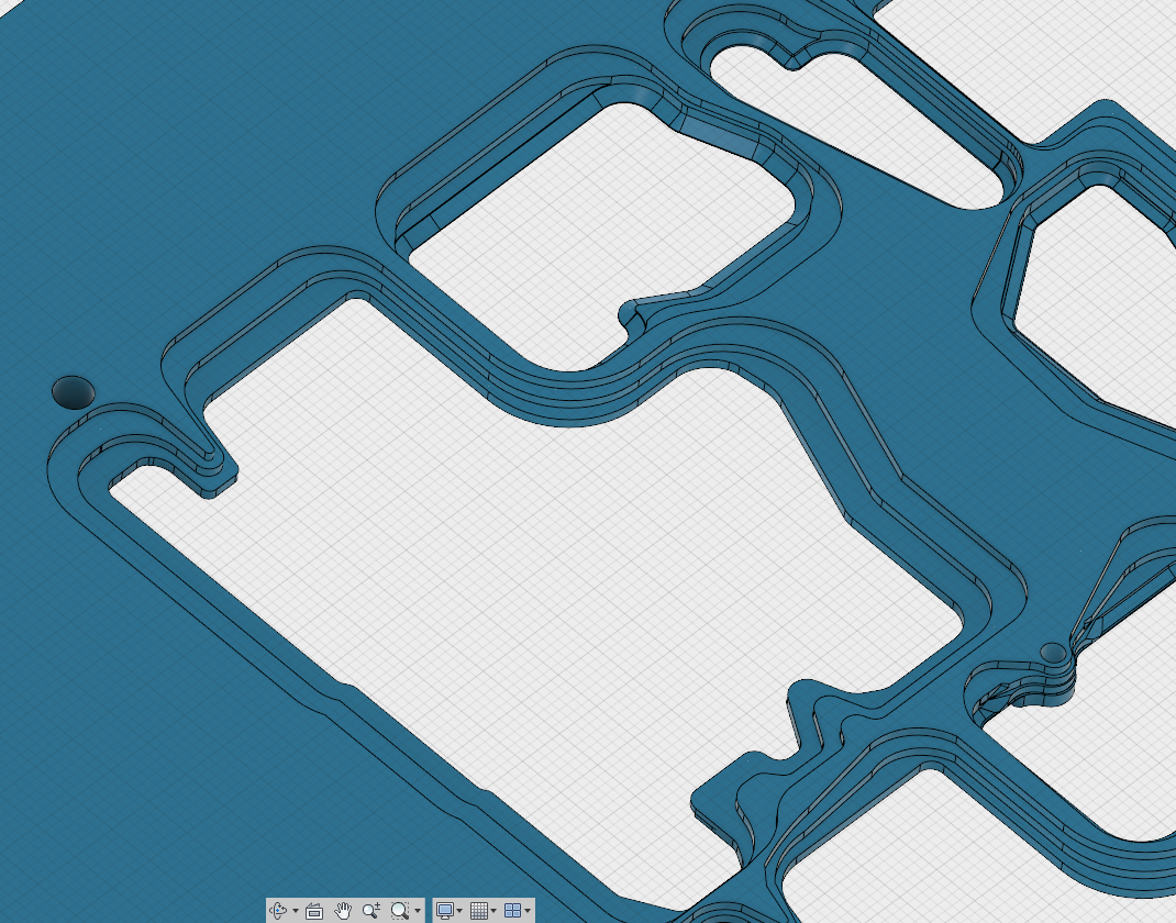

Good day,
I am busy cutting a solder tray for PCB manufacture. One of the requirement is that the bottom of the tray, that lies against the PCB, at the area that will be exposed to the solder wave, be chamfered at 60 degrees.
The problem is that some of the step faces are to small to accept a 60 degree chamfer and that is where it ends. Fusion will not identify the areas it cannot do. is it possible to chamfer the areas it can at the max length and angle and the areas it cant, just leave out.
I have been able to do it manually, by projecting the hole through the tray to the bottom of the tray. Then I extrude the sketch with a 60 degree angle. Now I have a large plug with 60 degree angle. I take the projected sketch and create an offset that stays within the bounds of the steps on my object. I extrude that up subtracting it from my plug.
The plug now has 60 degree corners but fits into the bounds i need. I move it down into position, into the hole, cutting off the corners with the 60 deg edge, and subtract it from the main. leaving me with, mostly the desired effect.
Problem is it takes forever. there must be another way to do this?

Have you tried deselecting 'Tangent Chain' in the chamfer dialog? It should be pretty straight forward (although time consuming and tedious) to just select the boundaries that are wide enough for the chamfer.
An easier way to find the invalid boundaries is to start a new sketch. Project the inner boundary and the first step boundary. Calculate the width of the 60 degree chamfer at the first step height. Offset the inner boundary that width (Note: you can use a formula for the calculation).  Anywhere the offset line crosses the first step boundary is not valid for the chamfer.

But it is a bit frustrating in that you have to select everything before you commit the change. If you have not selected enough you cannot continue after it commits a change and if you have not selected enough same problem. i get better result with my subtracted plug.
once an area has been half chamfered i.e. chain x has been chamfered, then chain x+1 cannot be chamfered anymore because some of its geometry has changed.
I will play around a bit more see if i can fiddle it in a different way.
If i am going to project the boundaries i might as well draw my plug. I am not too concerned if some of the geometry is messed up by the chamfer. There should be a strict setting and a non-strict setting. strict i want the algorithm to preserve all geometry and non-strict i don't care what happens toward the top as long as you don't make the bottom hole bigger.

Since chamfer doesn't work, try using a sweep

I've made an attempt with Loft in Inventor. IMO, creating this shape following the existing sketches is impossible.

It may have helped it you named the bodies so your design is easier to analyze.
What did you intend to achieve with this triple stepped approach ?
Where are the cut-out features that create all the big openings ?

How are you going to manufacture these infinitely thin surfaces on the poor side of your designs ?

The only reason for the triple stepping approach is because i have never been able to "hollow" out the tray as i would like without some exotic complicated fiddling. They normally use a bull nose to level down from the bottom to where the wave solder hole is. that is where i am heading hopefully.
Also solder is hopefully viscous enough to ignore all the steps.

Since you have more designs to do, it would pay to learn how to do them correctly. Using either Sweep or Pattern on Path with the profile of the bullnose bit would be much better than the steps you're using.  When it comes time for machining these, you'll find that it will be much more accurate and faster to use the bullnose bit.  The chamfers you have currently modeled will not be able to be machined completely as you have not allowed for the width of the chamfer tool.
