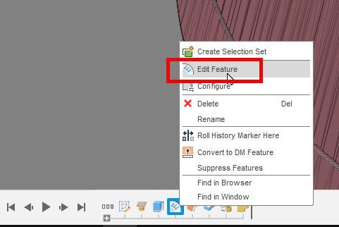

Sorry that I missed the "Deboss" note.  Due to this fact, the original model cannot be used.  I have attached a new one for your use.  Please not, the depth of the Deboss is -4.0 mm.  If you want to change it right click on the Emboss feature IN THE TIMELINE and change it there.  You are limited to the depth by the wall thickness of your model.  As I mentioned before, be patient if you change the value, it takes a long time to update.
