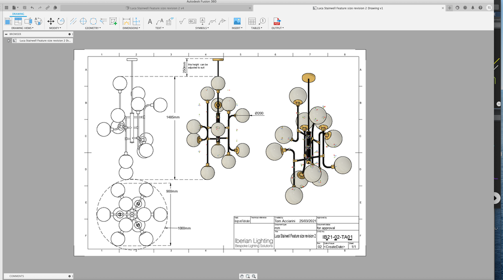

Hi all,
I have been building this design for a client. It features a mix of bodies and components some imported as arrays with elements de-activated.
I have previously created drawings from the design and rather than update these I tend to create a fresh drawing for the revision. ( I keep the previous versions as parts of the design are parametric to allow for changes, and this way I keep a record of the sizes )
The design was started before the JOs had the directional indicators. I have changed some attributes and redrawn some components today and the drawing now has all JOs showing, even ones for non active components. I have gone back to the start of all components but cannot get rid of them even when they're turned off in all the components.
Is there a way to eliminate them from the drawing?
468 Views
1 Reply
Reply (1)
ClintBrown3D
Hi @sales
This is a known issue, we are working on a fix. Please see this post for updates: https://forums.autodesk.com/t5/fusion-360-support/origins-visible-in-shaded-view-drawing/m-p/1014777...
