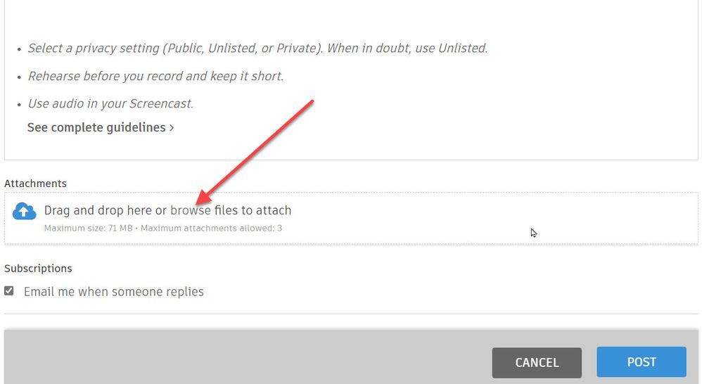

Please attach your model so the forum users can use it to help you.  If you do not know how to attach your model, open it in Fusion360, select the File menu and then choose Export and save the .F3D file to your hard drive. Then use the Attachments section of a reply forum post to attach it.
