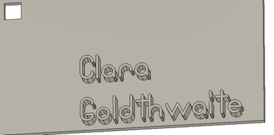

I created a sketch with Arial font and was able to extrude it just fine.  But I have another font that I just installed on my PC (Win 10), and it will not extrude.  The font is called Bowhouse and I got it here:
https://www.1001freefonts.com/bowhouse.font
I attached the f3d file.  The sketch with Bowhouse font is in the "Clara Dog Tag" component

Hi, @SGoldthwaite.
I also had problems with fonts in the past, but I couldn't remember if it was from OTF or TTF fonts.
I checked here and this Bowhouse didn't work heretoo. I converted these fonts to TTF and it worked, after restarting Fusion:
To make the conversion I used https://convertio.co/pt/otf-ttf/,  but I attached here the new files.
