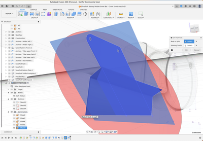

it's my second sheet metal part I am trying to construct and a bit over my head...
I have a bit more complex geometry, where I would like to have the projected line go straight over a bent part. Hard to describe, but easy to show:
To achieve this, I bent the part with two flanges and then split it with a plane and removed the unused part.

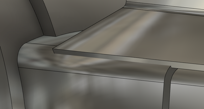

But when I want to flange the now cut part, I get an error:
The error message:
Can't complete the sheet metal operation due to an internal error. Checkt the body and bend parameters, then try again.
I assume I broke some sheet metal stuff by switching to the solid workspace, splitting and removing the part, switching back and try to flange.
What could be an alternative approach to my way to get a straight line when looking at the part from front?

TheCADWhisperer
Trim surface.
Thicken.
Convert to Sheet Metal.
