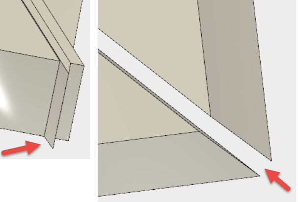

I have a 4 x 4 x26" post body.  I import this post body into another model.  I then want to cut a hole into the imported post component.  I can't find a way to modify the imported component.  How do I do this?

I have attached the archived file.  Thank you.
TheCADWhisperer
Backing up a minute to the part before imported -
I suspect this is not your true design intent:
You have an overlap on two corners and a gap on the other two.
happyday.mjohnson
Correct.  I tried aligning the two bodies (the end piece and the post), but as you show - did not do correctly.  The main trouble here was my inability to make a good endpost.  I was challenged to make a body that came up to a point.   If I fix this, I assume I still will not be able to make a hole on the 4x4 post component?
