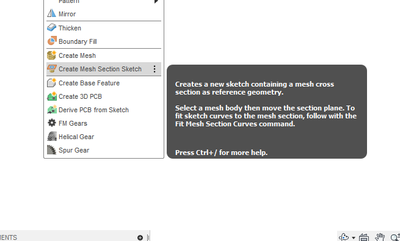

MRWakefield
I'd use a Mesh Section Sketch for something like this.
Once you've created your mesh section edit the sketch and use 'Fit Curves to Mesh Section' to create and refine geometry you can extrude.
Hope this helps.

Awesome, this is exactly what I needed.
Thanks for the help.
